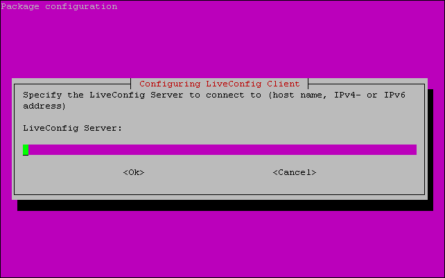

The installation program first asks you about the LiveConfig server to which this client should connect. Enter its host name or IP address:
LiveConfig server to connect to

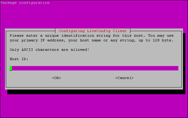

You will then be asked to enter a unique “host ID”. With this ID the new client can be clearly identified by the LiveConfig server; as a rule, you should use the official host name of the client for this:

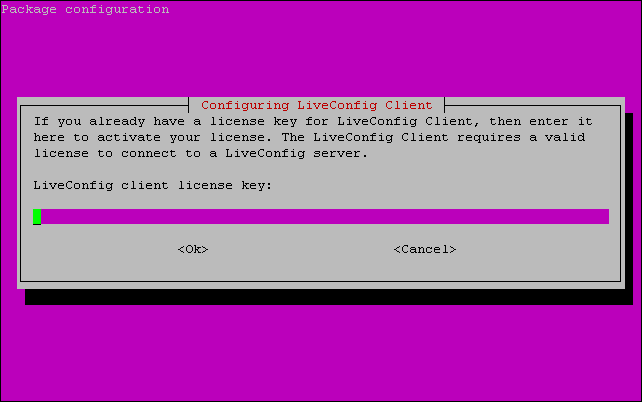

Finally you’re asked whether you already have a license key for LiveConfig client. If you do, then enter it here, otherwise just leave it empty.
License key prompt

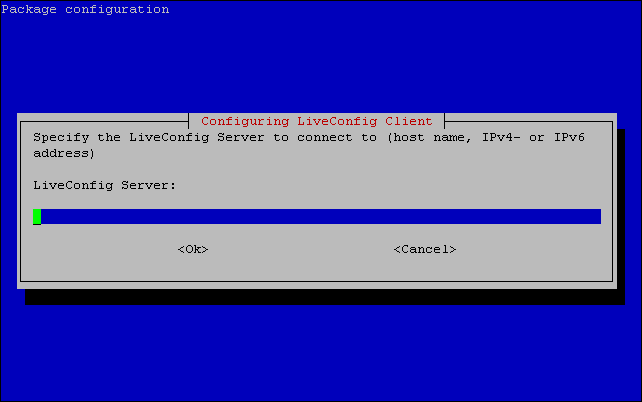

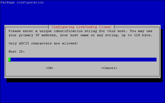

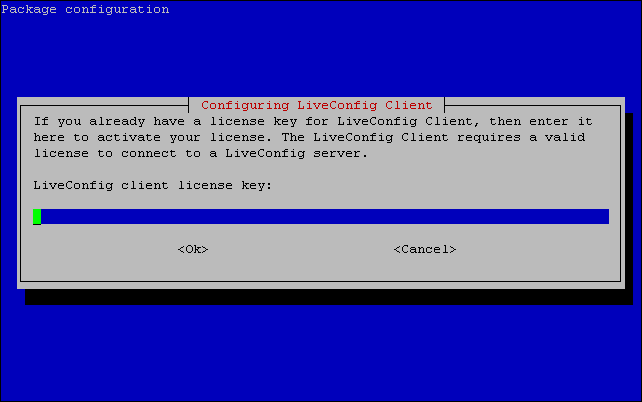

License key prompt
